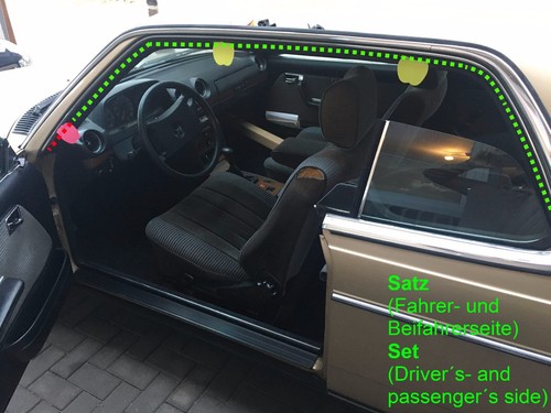

      http://www.ebay.at/itm/Mercedes-W123...EAAOSwWxNYqexw
      cod...A1236900398 SEAL
      FRONT DOOR, LEFT BOTTOM
      cod....A1236900498 SEAL
      FRONT DOOR, RIGHT BOTTOM
      pt curiosi...

              • #53
                caut chedere cine are ceva second in stare buna...cumpar!!!!
                Am auzit...ca ar merge cele de la vectra C...verific maine si dau de stire...fac si niste poze..daca gasesc la dezmembrari
